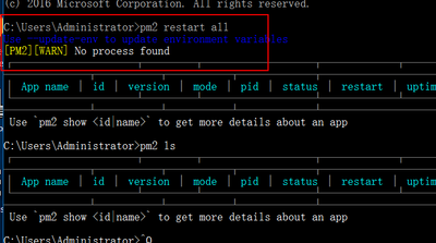

I installed thingworx flow successfully yesterday and ran command "pm2 ls" showed the complete components at the time . However , today when I open the VM machine but found "pm2 ls" shows nothing.
What's I've tried:
1. run command "sc start RabbitMQ / rabbitmq.service" but it tells me the service is already running.
2. restart the workflow subsystem, but it doesn't help
3. I can access thingworx foundation with host and port which were specified when installing work flow, but I cannot open https://<host>:<port>/Thingworx/Composer/apps/flow/#/
If the workflow doesn't launch automatically, how can I launch it manually ?

Try
pm2 restart all

Yes, thingworxflow, ThingWorxFlowNginx, RabbitMQ are running services in my machine. so why "pm2 ls" return nothing and I cannot open https://<host>:<port>/Thingworx/Composer/apps/flow/ ?
