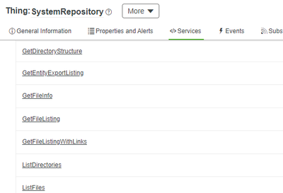

There are some OOTB services which you can use to list the files\directories in a repository, refer below screenshot,
Services are explained here
