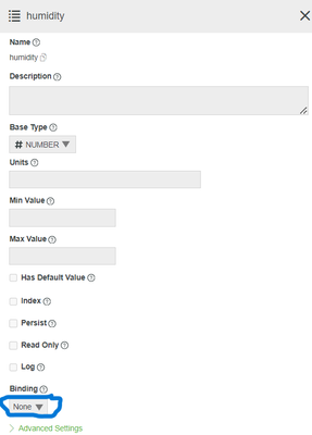

Yes its works for me by creating a new ThingTemplate insted of GenericThing and assigning to a  createThing service .
but In  newly created thing I m not able to bind Kepware tags to the  Thing property. It shows Disable option whenever I hover a courser on Binding.
Thanks.
Rocko
(To:Pratik_Aswale)
Your ThingTemplate then should have RemoteThing as Base Thing Template, not Generic Thing. You can check this on your thing t1, somewhere in the template hierarchy will be RemoteThing.

Hard to tell without knowing your used templates, but is the Industrial Thing connected? After CreateThing, did you run EnableThing and RestartThing as suggested here?
Things["TestThing"].EnableThing();
Things["TestThing"].RestartThing();
Pratik_Aswale
(To:Rocko)
@Rocko
Yes, Now its working fine.
