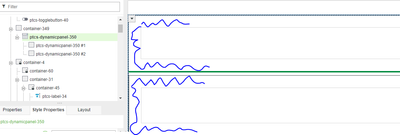

Hello all,
Does anyone know how to remove this extra space in dynamic panel ?

Hi @Velkumar,
Depending on your ThingWorx Platform version, the following CSS might not work, but have a try adding below code to your Mashup's CustomCSS
ptcs-dynamic-panel::part(panel-wrapper) {
    position: unset;

It worked on 9.0!
Thank you
I have given AnchorLocation: Left. When i added this css code, the space on the left side panel disappeared. But in my case, the space on right side of panel should be disappeared. What should i alter in this css code?
Actually this CSS makes all side to disappear not particular to left or right
