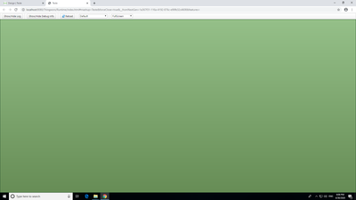

I have this mashup:
I wanna see it in my smartphone but in the URL there is "localhost".
Can I see it in my smartphone or other device?
Yes, as soon as your phone is on the same network with your server or your server has a public IP address.

Hi @einsfele.
You won't be able to access the mashup from your phone using localhost in the url.  If your phone is on the same network, you should be able to access it using the hostname assuming the relevant port is exposed.  It may be necessary to set up a firewall rule to allow access.
