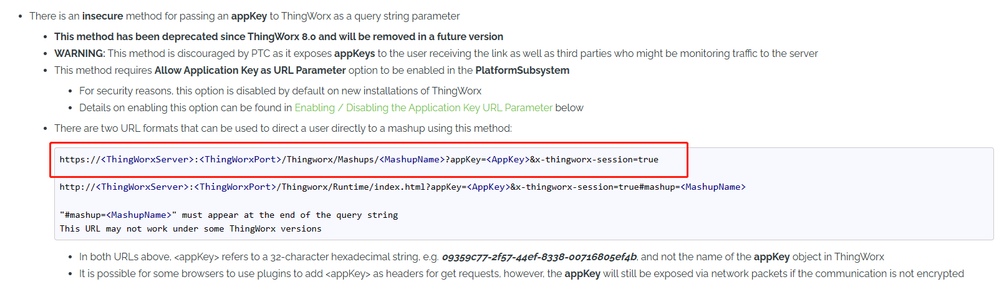

Hi @Snoopy_hu

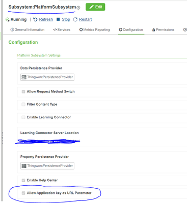

Have you enabled "Allow Application key as URL Parameter" in PlatformSubsystem
Also, I can see you used a different URL format
Please use the below format
https://<<HOSTNAME>>/Thingworx/Mashups/<<MashupName>>?appKey=<<APPKEY>>&x-thingworx-session=true

Hi @Velkumar ,
Yes, I have enabled "Allow Application key as URL Parameter" in PlatformSubsystem; and I've tried the format you recommended, but it still converts to the format I asked the question about at runtime.

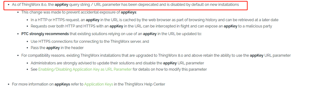

Hi @Velkumar
I just checked the documentation and unfortunately, for security reasons, the system has disabled the use of the APPKEY lookup feature in the new version.

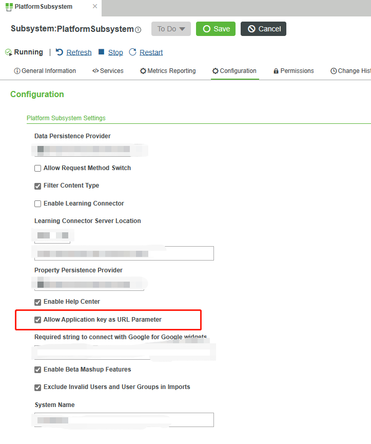

Hi @Velkumar
I've turned it on, but it still won't run.Why is that?Please help me.
