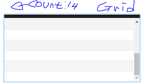

I want to connect the database in mashup.
KANGJAEHYUCK
I've read this manual.
https://developer.thingworx.com/en/resources/guides/data-storage-methods/dsm-value-streams
and
https://developer.thingworx.com/en/resources/guides/external-databases/completed-examples-database
Connection succeeded.
row num :15 = result count : 14
If row num is 15 or less, the number of grids is 15.
The number of row num 10 is 10 if the grid.
The number I want is the same.
However, there are no values in the grid.
I put ojdbc6 in Tomcat and Java.
I thought about the cross domain, which is one of the browser constraints
But, The IP and thingworx IP of the database are the same.
I think I did it wrong.
I'm new to Thinkworx.
I'd like to put data in the chart and the grid.
Can you help me?

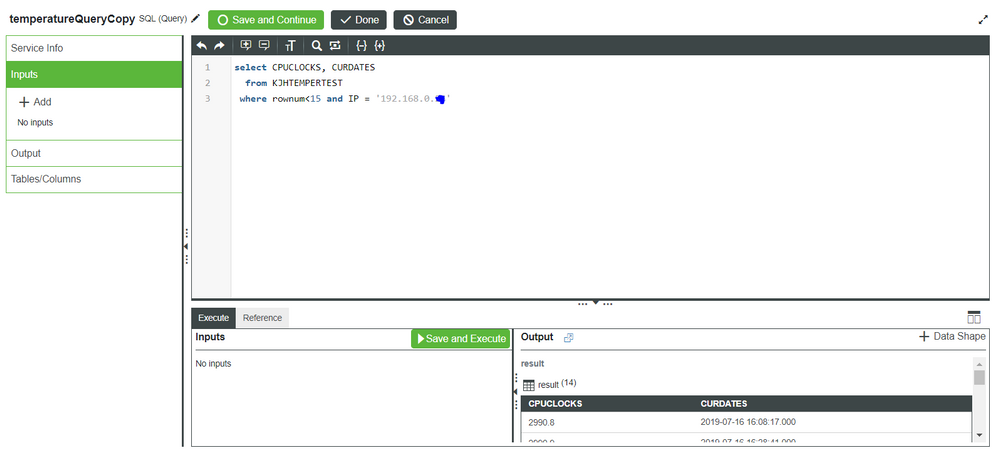

Did you create a Data Shape to define the data structure you return from your service? If not, there's a handy "+ Data Shape" button on your first screenshot -- use it, specify this new data shape for the return type of your service and redo binding in your mashup. If you do everything correctly, you should see the CPUCLOCKS and CURDATES columns in your grid.

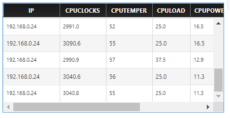

Thank you very very much.
I didn't expect that to be a problem.
