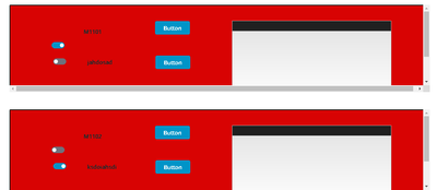

screenshots of both my thing with infotable property and mashup with the collection:
As you can see the grid does not show the inftable values.

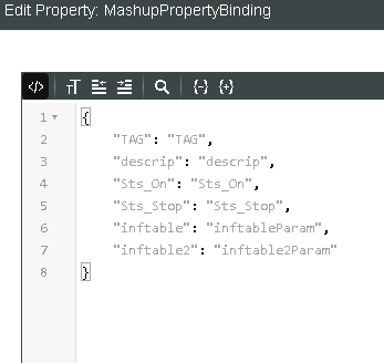

- And my bindings in the collection are these:

With the Collection property "MashupPropertyBinding"

Collection propertybinding:

Also, when I bind the parameter to the grid widget, I don't see the columns... Don't know why, it seems that the Grid doesn't understand the parameter as a data source, it remains with the "Must be bound to data" message
@CaShimiz ,
Did a little extra investigation. In my test case I used the Legacy Grid Widget (which is still available), the Grid Advanced Widget seems to have an issue, The Article - CS337412 Advanced Grid displayed as target Mashup of Navigation function is empty when populated by Mashup parameter in ThingWorx the issue has been addressed in ThingWorx 9.0.6 and ThingWorx 9.1.1.
I changed my test case to have both grids and see the same type of items in composer as you are reporting.
Can you switch to the Grid Widget?
Peter

I switched to the legacy grid and apparently is working fine now!!
Thank you so much Peter!! I've been struggling with this for the last couple of days now.
I'm so happy, thanks again!!!
