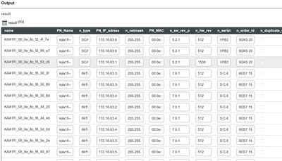

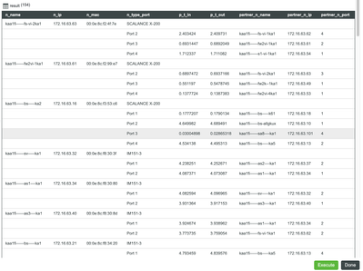

I made a service like thousands of others. But one thing baffles me, output of this service which is Infotable, is also editable. I have never seen this before. As far as I can tell, there is no option in composer, nor in datashape nor in service output which would indicate that this even possible.
What is goin on.
Screenshots explain what I mean. One service's output looks like any other (non editable output), one is almost the same in a nutshell but output is editable.
Anyone?
Editable:
Standard:

Ok, I found it.
Problem is in datashape itself.
I dont understand the logic behind it, but here it goes.
Datashape for this service output has been created from GetPropertyValues service.
Others I mainly create manually, this one had a lot of columns and names mattered.
If I open XML files for that datashape entity I can see that there are other parameters (aspects) in FieldDefinition. Mainly
aspect.isReadOnly="false" can cause that this cell could be edited.
I dont understand the logic behind it since if there is no way how you can set those aspects when you designing Datashape entity, why would not be removed.....
