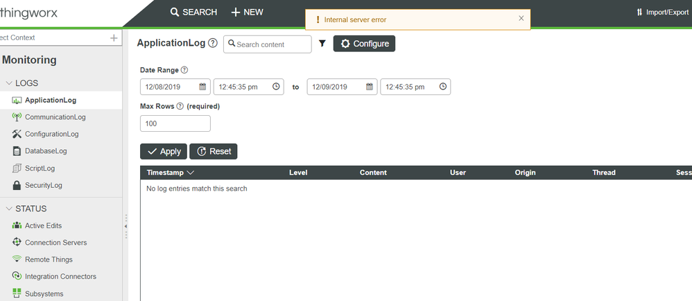

Internal Server Error when opening Monitoring->ApplicationLog
I got error "Internal server error" when opening monitoring->ApplicationLog and click ,  no such error occurs if open other Log , for example: ScriptLog.
Please check the attached error.log.
Thingworx 8.5.1.   Postgresql 10.11, Windows server 2016
Sean
In the log we have:
com.thingworx.common.exceptions.InvalidRequestException: Unable to Invoke Service QueryLogEntries on ApplicationLog : java.nio.charset.MalformedInputException: Input length = 1
Please check the charset/encoding set in Tomcat/Java options. Usually this is UTF-8.

@raluca_edu ,
Thank you,  I did miss the tomcat configuration.  The errors gone after adding it .
