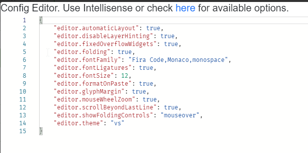

Is Monaco Editor is available in ThingWorx? Is there any Matric Document and extension file available for the Monaco? If not what are the other Editors that we can install for more user friendly to code in TWX which are supported.

"ThingWorx Monaco Code Editor": https://github.com/ptc-iot-sharing/MonacoEditorTWX

Hi @LC_10152029
Any issues you encounter using that third party content should be reported in the GitHub Issues section of that project.
Considering this, please report this issue there: https://github.com/ptc-iot-sharing/MonacoEditorTWX/issues
I strongly suspect that you did not import the correct extension, as the release contains the metadata.xml file, but let's continue the discussion there.
You need to import one of the highlighted zips from the releases page https://github.com/ptc-iot-sharing/MonacoEditorTWX/releases :
I assume you tried with the sourcecode.zip file.
Edit: But you only need to import the extension if:
  • If you want to also use the MonacoEditor widget, to display code during mashup runtime, you will need to import the ThingWorx extension listed under Releases. It should be the one named MonacoScriptEditor-VERSION.zip.
See installation instructions https://github.com/ptc-iot-sharing/MonacoEditorTWX#installation .
