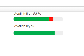

You can use Shape Widget in 1 Contanier (required height & width & grey background) by pass numeric value to Data widget property and updating below given properties in widget you can achieve progress bar.
  • EnableDynamicFill  - True
  • DynamicFillOrientation - Horizontal
  • ShapeType - Rounded Rectangle
  • RectangleCornerRadius - As per requirement
  • Shape -State Definition (defined colors based value)
Expected Out:
Thanks & Regards,
Arun C
