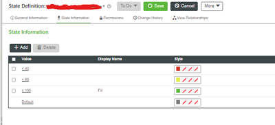

You need to create a new State Definition entity and need to define the State Information based on Value. And update that in shape widget.

Thanks! but can you show me the Shape -State Definition (defined colors based value please?
Because when I trying to do this but my shape always fulfill with same color.
