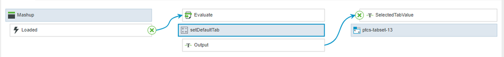

I have never been able to get the DefaultTabNumber property to work for tabs, so I create an expression that runs when the Mashup is loaded and bind it to the tabset's SelectedTabValue. The expression content is: result = "TabValue1". Every time the mashup is displayed in the popup, the Mashup Loaded event fires and sets the first tab as the default.
