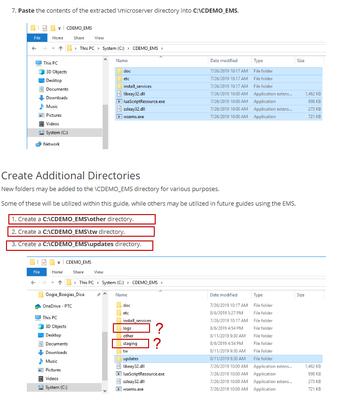

Hello guys,
Let me expose some issue that occurs during learn step on Learn Path module. Exactly in the guide called  “Use the Edge MicroServer (EMS) to Connect to ThingWorx. In this guide the EMS can`t connect to the server. Appear code 201 error.
I tried change the log level, changed to DEBUG.
Like this link expose.
https://community.ptc.com/t5/ThingWorx-Developers/ERROR-Connecting-WS-EMS-on-Raspberry-Pi/td-p/569910
Became the same error.
I noted a little strange difference between the number of folders that appears in the example…
Maybe it would be the problem? Or other procedure.
Thanks.
Att. Diego Tavares
Hello @slangley
I´ve concluded this situation with @emoreira, meeting.
He gave me the text complement to put in the config.json file.
And tham it connected successfully.
Let me expose below.
    "ws_servers": [{
        "host": "xxxxxx",
        "port": 8080
    "appKey": "xxxxxx",
    "logger": {
        "level":             "DEBUG",
        "publish_directory": "C:\\CDEMO_EMS\\logs",
        "publish_level":     "DEBUG",
        "max_file_storage":  2000000,
        "auto_flush":        true
    "http_server":  {
        "ssl": false,
        "authenticate": false
    "ws_connection": {
        "encryption": "none"
    "certificates": {
        "validate": false,
"allow_self_signed": true
    "tunnel": {
        "buffer_size":    8192,
        "read_timeout":   10,
        "idle_timeout":   300000,
        "max_concurrent": 4
    "file": {
        "max_file_size": 8000000000,
        "virtual_dirs": [
            {"other":   "C:\\CDEMO_EMS\\other"},
            {"tw":      "C:\\CDEMO_EMS\\tw"},
            {"updates": "C:\\CDEMO_EMS\\updates"}
        "staging_dir":  "C:\\CDEMO_EMS\\staging"
We had diferences on logger level,  port and certificates.
Thanks for atenption!
Hugs,
Diego Tavares

Hi @DiegoTavares.
I have notified the team responsible for the creation of the guide.  In the meantime, I will try to investigate for addressing the issue you encountered.
Regards.
--Sharon

Hi @DiegoTavares.
Which version of the EMS are you using?
Regards
--Sharon

Hi @DiegoTavares.
I'm happy to hear you found a solution, and thank you for sharing it with the community!
Regards.
--Sharon
