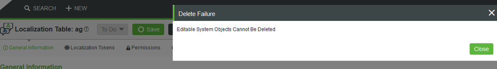

When importing an extension a localization table was inadvertently imported as well. The issue is that this table has the attribute "aspect.isEditableSystemObject="True"" which means that it cannot be deleted from the Composer.
In a similar issue the solution was to export the localization table, set "isEditableSystemObject" to false and import it. However this does not work in this case as the importer ignores the new edited file with the message: "Editable Localization Table Already Exists, Ignoring Imported Object Except for Tokens LocalizationTable [xx] "

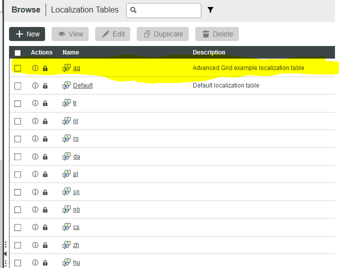

In ThingWorx Composer, please browse to Localization Tables and send a screenshot of the tables listed there.  Also, please advise which one you're trying to delete.
Regards.
--Sharon
CMabr
8-Gravel
(To:slangley)
Here is a screenshot of the tables... The table "ag" is the one I wish to delete but am unable to.
The following message is displayed when trying to delete it:

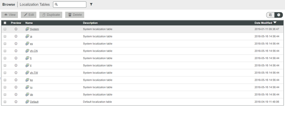

Apparently the newer version of the examples no longer includes this localization table.  Here's my screen after doing the import of the one that comes with the 4.1.1 extension:
Localization tables.PNGPlease send me the .xml you imported so I can try to come up with a way to delete it.
