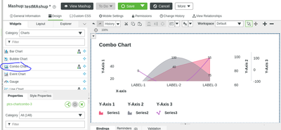

Hi @IR_10730188
You can use a legacy label chart in Thingworx 9.3.  When you upgrade to 9.4+ you can replace it with ComboChart ( available from 9.4).  Also, Legacy LabelChart is not removed in Thingworx 9.4
Or you can develop your own widget based on ChartJs or ECharts
Combo bar/line | Chart.js (chartjs.org)
Examples - Apache ECharts
/VR
