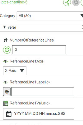

Hello.
I have added reference lines to my chart but i cannot see the labels. Also, anyway to customize the colors for each reference line?
I am using ThingWorx 9.3.2-b411

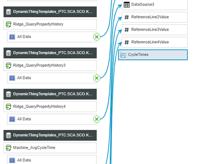

Hello @LP_10027711
I am using TwX version: 9.3.1 and issue is not reproducible on my end. pls check the attached Screenshot for your refernce. I have added 3 reference line and Label is present for 3 of them. Pls recheck on your end.
Below is the Screenshot from helpcentre guide.
Also, I am checking for the second part of your query. Meanwhile pls check for the label on your end. Let me know if it works for you.

I think there is supposed to be a check box somewhere to show labels?
Where? i tried looking and couldn't find it
