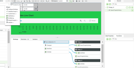

Hi Developers,
I m trying to load data in Line Chart by using Date Time picker widget after selection of specific date and time but still data is not showing in Line Chart.
please check my binding.

Use debug tools to find out if the service was called and returned data successfully (green thumb icon)
If yes, you need to check the binding of the result data to the line chart (Fields Data, XAxisField and DataField1)
If no, check error logs, maybe also bind "RangeChanged" event.
