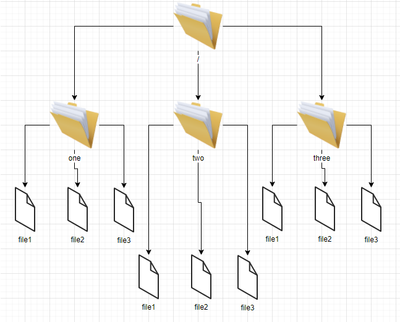

I need an infotable that has the path & filenames of all the files in a file repository, irrespective of the path.

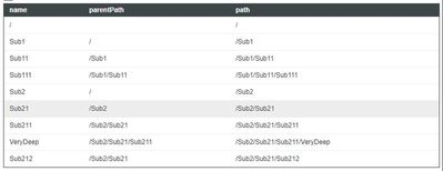

@SB_9732186 It works for arbitrary directory hierarchy.
The code gets the hierarchy from the GetDirectoryStructure and then just iterates over it. Here is the InfoTable returned by GetDirectoryStructure.

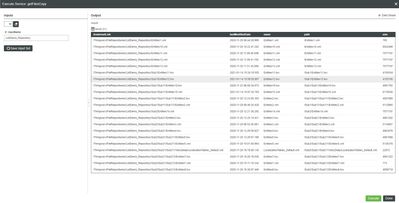

Here is a bit better commented code
var params = {
  infoTableName: "listFiles",
  dataShapeName: "FileSystemFileWithLinks"
// Initializing empty InfoTable with the appropriate shape
var listFiles = Resources["InfoTableFunctions"].CreateInfoTableFromDataShape(params);
// Getting the directory structure of the repo
var repoDirStructure = Things[repoName].GetDirectoryStructure();
// Iterating through all the directories in the repo
// and merging the list of files in each
for (var el in repoDirStructure.rows) {
    var listFiles2 = Things[repoName].GetFileListingWithLinks({
			path: repoDirStructure[el]["path"]
    var params = {t1: listFiles, t2: listFiles2};
	listFiles = Resources["InfoTableFunctions"].Union(params);
result = listFiles;
 The final result returned by the service:

Let me give you an example:
The service should return an infotable:
Path                                       Filename
/one                                       file1
/one                                       file2
/one                                       file3
/two                                       file1
/two                                       file2
/two                                       file3
/three                                    file1
/three                                    file2
/three                                    file3
Thanks.

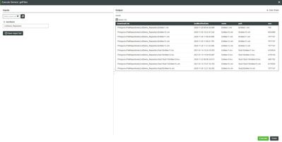

if the approach mentioned by @DmitryTsarev works for you, then it is good as it seems to be more simpler and straight forward.
The one above was a quick and dirty code.
Here is the sleeker version (no "init" step in the beginning and thus no "if" inside the loop):
var params = {
   logger.warn("repoDirStructure"+repoDirStructure[el]["path"]);
   // Merging files from all subfolders
result = listFiles;
var params = {
result = listFiles;
