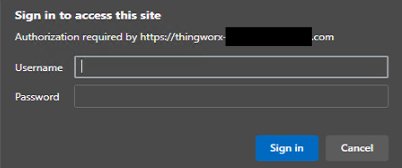

After a while (more than an hour), a login pop-up appears at the top of the mashup (see screenshot). The application continues to run in the background, but the pop-up is still there. I don't understand why the mashup requires a login, when it's still working and has an Appkey.

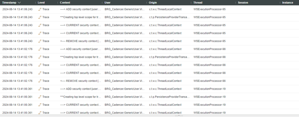

I also checked the application logs, but no errors were reported. The only thing I can see are these traces, which repeat very quickly (see screenshot)
