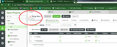

Hi, Team.
How I can fix it?
The Thing to attach on Mashupe is offline.

PaiChung
22-Sapphire I
(To:Telles)
That indicates that the 'Remote type Thing' this entity represents is not connected.
This Thing is expecting a connection and information from maybe Kepware or a ThingWorx Edge Agent

PaiChung
22-Sapphire I
(To:Telles)
Then you can just ignore that, the Thing will function fine even without being connected.
Not sure if this was a pre-created Thing, but else if you use a ThingTemplate that isn't based on RemoteThing or IndustrialThing you wouldn't see that at all because it won't expect connectivity.

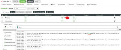

Hi!
Understood!
Also I´m use the Trial version to do this.
My ESP32´s code can generate the URL to TW, but return -1. If I copy and paste the same URL in the browser and refresh the Property in Thing, it has updated.
Follow my code and print screen.

PaiChung
22-Sapphire I
(To:Telles)
is there anything in the logs in ThingWorx application log?
