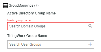

Not exactly - we have a project with a Thingworx Directory Service which has the group mappings from the Active Directory to Thingworx Groups - the problem is that the mapping and search functionality there only lets you select the AD Groups by name so that's when everything broke once the name was changed internally

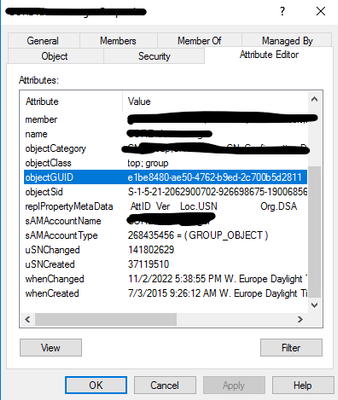

There are attributes for groups in Active Directory for groups that  have unique values: objectSid, objectGUID
It would be a great improvement to configure the mapping to those attributes instead of the group name.

Indeed - and how to do that using a Thingworx DirectoryService is why I created this topic. Sadly, in the group mappings it seems like you can only add mappings via common name.

But this is still a possibly correct approach: You could also use the ObjectGUID. It never changes.
