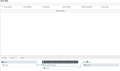

Hi there,
Looking to alter a grids information in run time by changing a Boolean value to a colored block.
Above is the mashup that I currently have. There is a column called online_status.
That is a number that will either be a 1 or a 0.
I would like to rather show a block that is green if 1 and a block that is red if 0
Is that possible with the current grid?
If so how can I achieve this?
Below is an example of what I'd like to achieve (I've blocked out information that may be sensitive):
Hoping anyone can help.
Thanks in advance.

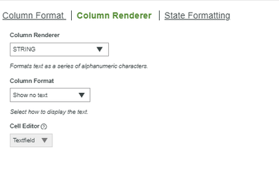

I have figured it out.

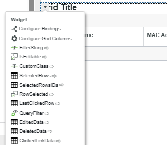

I went to Configure Grid Columns
Then I selected the column name that i wanted to edit, under column render, I selected the drop down string, and for the column format, I selected show no text.

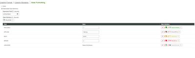

Then I selected State Formatting:
