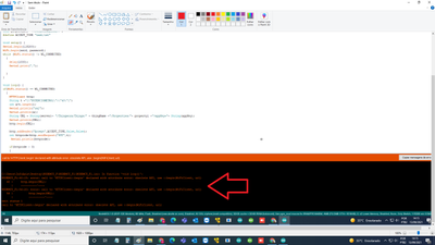

I try to send any sensors measurements from my board to my Mashup.
The code is worked in this url: https://blog.avotrix.com/esp8266-with-thingworx/ but the code has crashed like the printscreen. My library was recently downloaded, in another sketchs its works as well! How I can fix it?

All Core versions of ESP8266, above 2.7.4 crashed the code.
Just use 2.7.4 version
