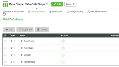

The below image represents the datashape that i created:

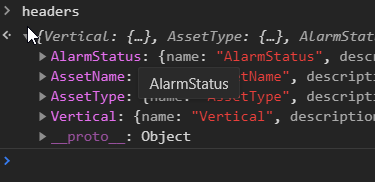

And the service returns, on widget extension, this order:
I want to receive original order from datashape.

Hello @FredSilva92,
Datashape fields have ordinal property, maybe it can help ordering them?
Constantine

Hi Constantine,
Sorry for the later answer.
Yes, i found that ordinal property that you mentioned the it fixed the problem.
Thank you very much for your answer.
