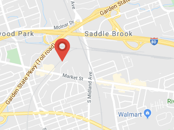

Is it possible to have multiple markers at the same location?  I noticed that I can only see one marker when they have the same geocode.  I need to be able to see all markers that are located at the same location.  They don't split up even if I zoom in.  I can only view one of the tool tip mashups since the other markers are hidden behind the first one.

Hi @slangley ,
I am trying to display all remote things on a list on the map.  Please see the screenshot below.  The list is shown on the right.  When a remote thing is located in the same location as another remote thing, the markers overlap and I am unable to bring up the tooltip mashup of the markers of the remote things in the same location.
Hi @slangley ,
This is what I want it to do:
