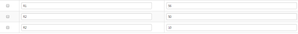

Hello!
I have an infotable with the following data:

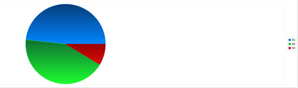

When displaying this data in the Pie Chart the second and third records are displayed in different colors:
Can this widget combine records with the same Label-field and color them in one color so that there are no such repetitions?
I'm not sure about the widget, but in case it isn't possible, you can easily group it on the server side:
var result = Resources["InfoTableFunctions"].RenameField({
    t: Resources["InfoTableFunctions"].Aggregate({
        t: infotable,
        columns: "col2",
        aggregates: "SUM",
        groupByColumns: "col1"
    from: 'SUM_col2',
    to: 'col2'
(Substitute infotable, col1 and col2 with correct names).
