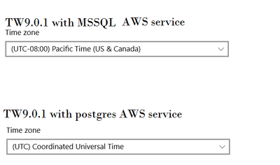

3. What is the Persistence Provider (DB) ?
4. What is the of the ThingWorx platform OS timezone ?

3. What is the Persistence Provider (DB) ? -> postgres for one environment & mssql for other
4. What is the of the ThingWorx platform OS timezone ?->

2. The timezones below are the one of the ThingWorx platform server correct (not the DB) ?

2. The timezones below are the one of the ThingWorx platform server correct (not the DB) ?-> yes timezones are of TW server and not DB.

So on the server that is currently using UTC, you can add -Duser.timezone=UTC on the Tomcat JVM (similar to CS306401) - to ensure that any change of the OS timezone does not affect Tomcat/Thingworx.
On the server that is using Pacific Time, you cannot change the Tomcat JVM TZ. This will shift your data.
Have you already ingested data (Data Table, Stream, Value Stream) ? R&D is currently working on a migration script (would it be  possible to open a support case) ?
