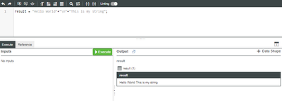

HI,
I am trying to insert a new line in string. I tried with this(below pic) but not working. Any help?

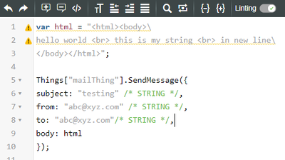

@Sruthi
When I pass string in the body I was unable to get the text in new line. But when I send html in body I am getting the text in a new line. This is the only way I was able to make it work.

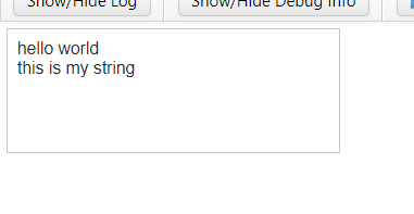

@Sruthi
Try displaying the result in text area widget in a mashup and it will be displayed in a new line. Refer below screenshot,

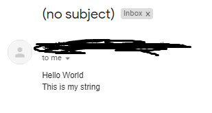

I am trying to send an email. In the body I need to send message with new lines.
Sruthi

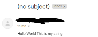

(To:Sruthi)
This is what I tried
and my result,

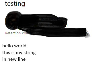

But I want my result to be like this,
@Sruthi
