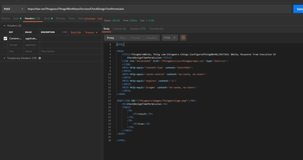

PFA the log files and also found below error in inspection window
But when I try to call service using postman I'm not getting any error. PFB PNG
