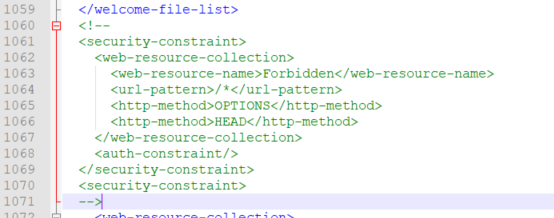

Thanks for sharing.
Please can you attach <Tomcat>\webapps\Thingworx\WEB-INF\web.xml file?
Did you add/modified web.xml file with any setting?

PFA the XML file.
Please comment lines 1060-1068 in web.xml and restart tomcat,flow, nginx services.
Raluca Edu
Velkumar
(To:raluca_edu)
Hi @raluca_edu
If I comment those line on web.xml, I'm 404 error while opening Thingworx.
/VR

Hi @raluca_edu
I have solved the issue. It is due to tomcat version, we upgraded to tomcat 9.0.
Now we are able to create or update Flow.
