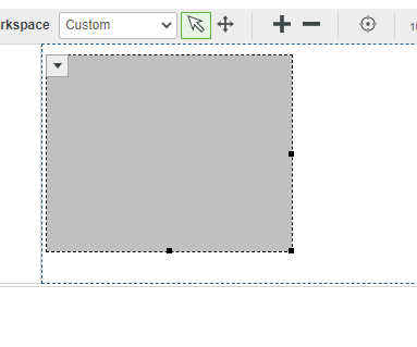

I'm not able to set background image on Shape widget.
Could any one help me on this
Thanks in advance

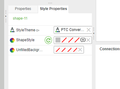

are you referring to changing the background style on shape widget? Some thing like this ?

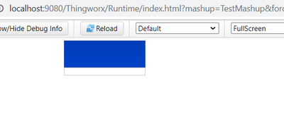

Hi @mnarang
I'm looking for something like this
/VR
