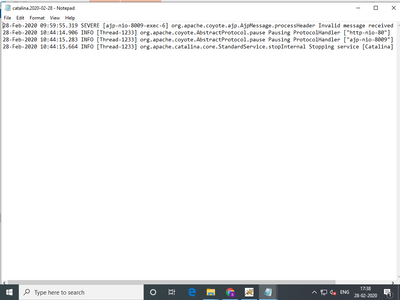

Sruthi
(To:Chrischhan)

Chrischhan
(To:Sruthi)
The only error i can see atm. is the first line of your catalina log (02-28)
lookup for this error there is a SO page where you can see a possible solution for that.
BUT if tomcat runs the days before, i assume you did not do any modyfications to tomcat.
my next steps where:
- Backup all logfiles (in TWXStorage/logs, Tomcat/logs)
- delete all logfiles (in TWXStorage/logs, Tomcat/logs)
- try to start tomcat and revisit the mentioned logfiles (catalina.out and Application.log) and look if there are any errors. (if there is any Console output to start Tomcat, that would be helpfull as well)

Actually, in configure Tomcat I unchecked the "use default" check box and gave the path for "java virtual Machine". Now my tomcat is running but Thingworx is not opening. It shows 404 error. I have attached all the "TWXStorage/logs" files generated today. Kindly help me with this.
