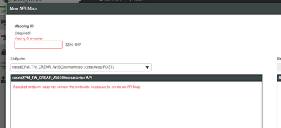

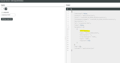

Hello everyone,
I am trying to connect to SAP using the OData Connector. We have been able to successfully perform all the GET calls but we haven’t been able to do any POST calls. We are receiving this error:
It seems that is not able to find the input parameters but we have defined them in the body:
Are we missing something? Do we have to create a swagger file with the definition of the endpoints?
Thank you!

Hi @saguiarde.
Which version of ThingWorx are you running?  This issue has been reported for ThingWorx 8.3, but may affect later releases as well.  At this point, we don't yet have a target date for resolution but support is being dropping on the 8.3 version this month.
If you're running ThingWorx 8.4 or above, you may want to consider using Flow which has an SAP connector built in.

Hello @slangley ,
I have updated to the newest version 8.5.6 and I still can't properly used the POST method in the OData connector.
Is there an extra step that I should be doing when requesting the call?
Should I use a swagger file to send the data?
Thanks!
