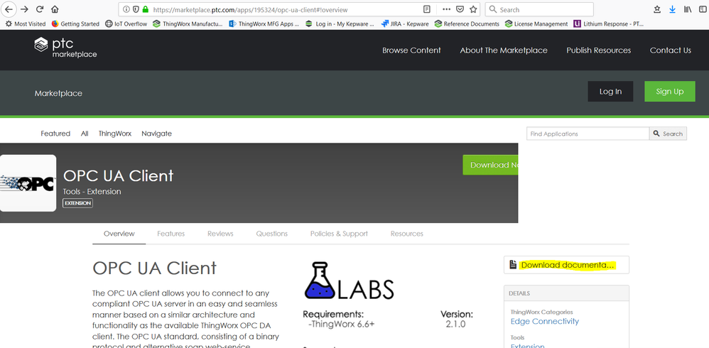

Did you install the .jar and config.json on the client side (OPC server)?  You may need to check the parameters in the config.json file.  You can find more information on this in the documentation available for this extension on the marketplace.
