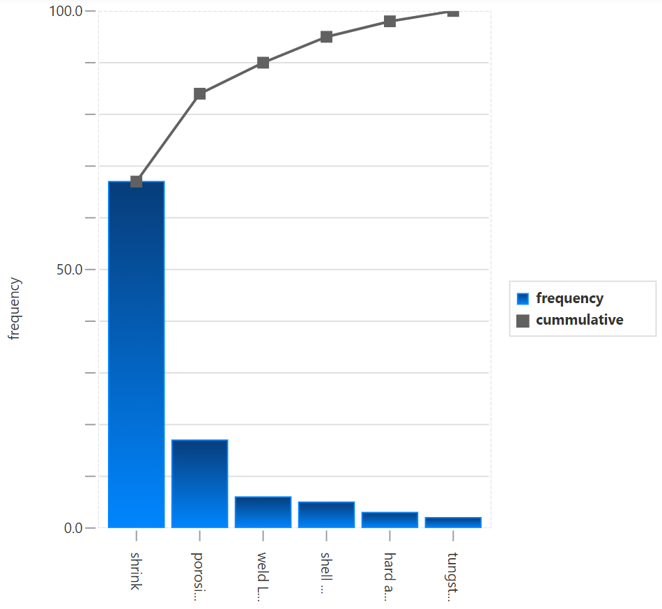

Hi everyone,
Does anyone here know the extension to show a Pareto chart in ThingWorx Foundation 8.4? Do I need to develop a custom widget extension to achieve that?

Hello @evanfebrianto,
You can implement it using the standard Label Chart widget with two data sources, one of which is displayed as bars, and the other displayed as a line with markers. Here's an example with the data from that Wikipedia article you linked:
Obviously, its look and feel needs to be improved, it's just the first quick version. I'm also attaching the source code for your reference (ThingWorx 8.5.4), it's really trivial.
Constantine
Thank you very much. It really helps
