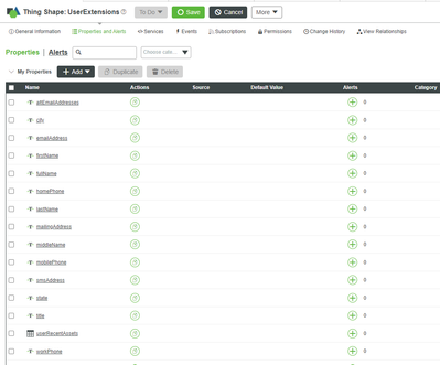

I defined a persistent infotable userRecentAssets in UserExtensions Thing Shape

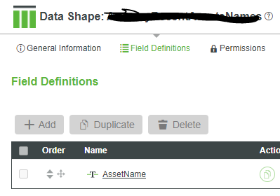

The infotable has a datashape defined like:
So I have
Now inside a service I am getting this infotable for current user like:
That works but when I want to check if there were any changes to my table I get this
What am I missing so I can see the values?

Composer probably isn't set up to see infotable values within user extensions.
So I think you will need to create a service (and maybe associated mashup) to see the values.
You can probably use a service that does something like
var result = Users[NameOfUser].NameOfUserExtension
set the output to InfoTable and then display it in a grid
Thanks for your response I have tried what you suggested (besides other approaches) but still no success, I opened a Ticket
