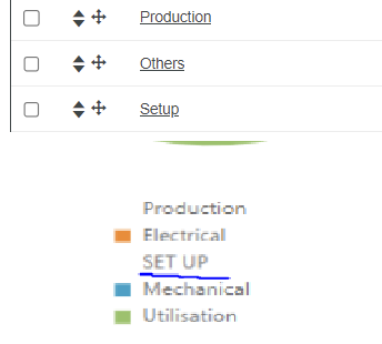

Also, check whether State Definitions Value matches with Service Output values
Here I can see SET UP is different from the state definition value Setup

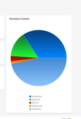

shraddha_21
(To:Velkumar)
Hi @Velkumar
This is the service output. The state definition values I have corrected. One thing is that if I remove state definition color formatting, it comes fine.

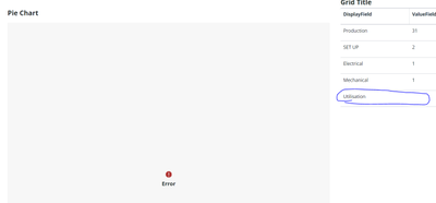

Based on sample data I found out null value for data Utilisation causing some issues in the Pie chart (in Thingworx 9.4.0)
Null value:

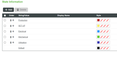

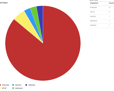

With some value:
State Definition:
Please provide the Default value in the State Definition
Could you please make the null value to zero and try again. Also let me know your Thingworx version
