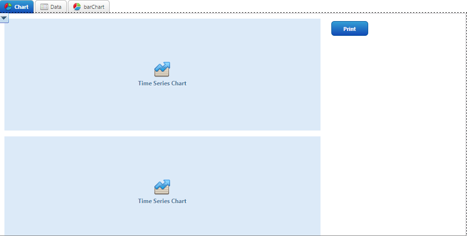

PrintButton Extension project
  • July 15, 2015
  • 6 replies
  • 9445 views

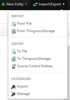

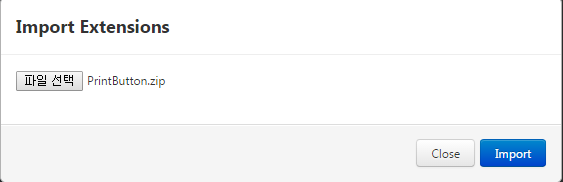

1. Import Extensions
2. Select File
3. Widgets PrintButton Drag & Drop

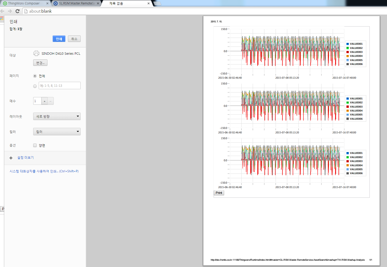

5. print button Click View

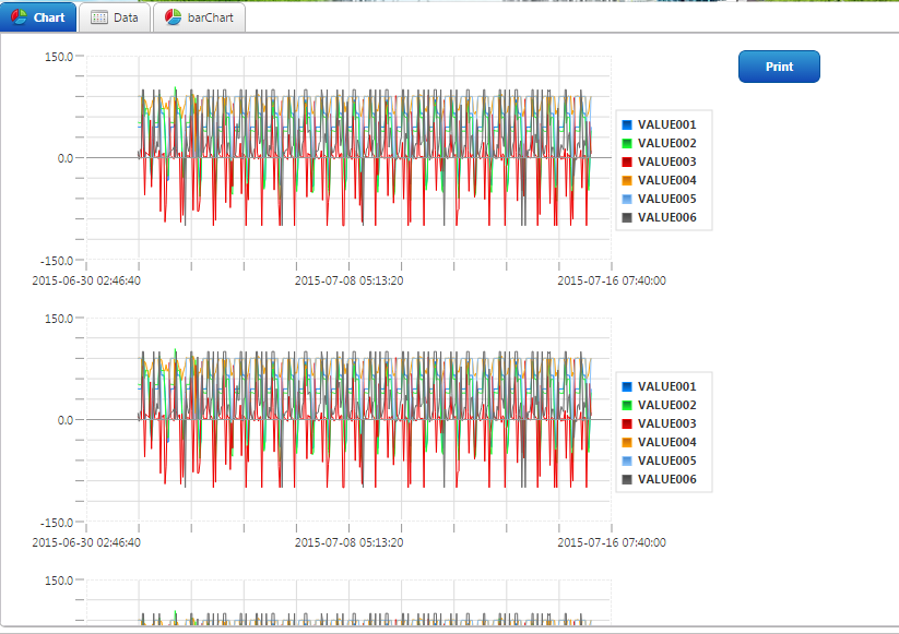

    Hi, I am trying to use your widget. It would be really cool, but it does not fully work for me..
    From some reason it cannot print root-Mashup. It shows the blank page. If I put my graphs inside of a panel, it rearrange them thus making graphs visible only partly. Any ideas how to print several widgets at the time and avoid the re-arrangement.

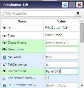

    Did you copied the correct name as hyun gu kim​'s instructions?
    4. chart parent panel name to printbutton UnitName Copy hyun gu kim

    Hello;
    I just tried the window.print() function but i cant use "window" keyword. So i use print() function in expression and trigger it with a button and it worked. I want to share if anybody need to quick fix about this issue.
