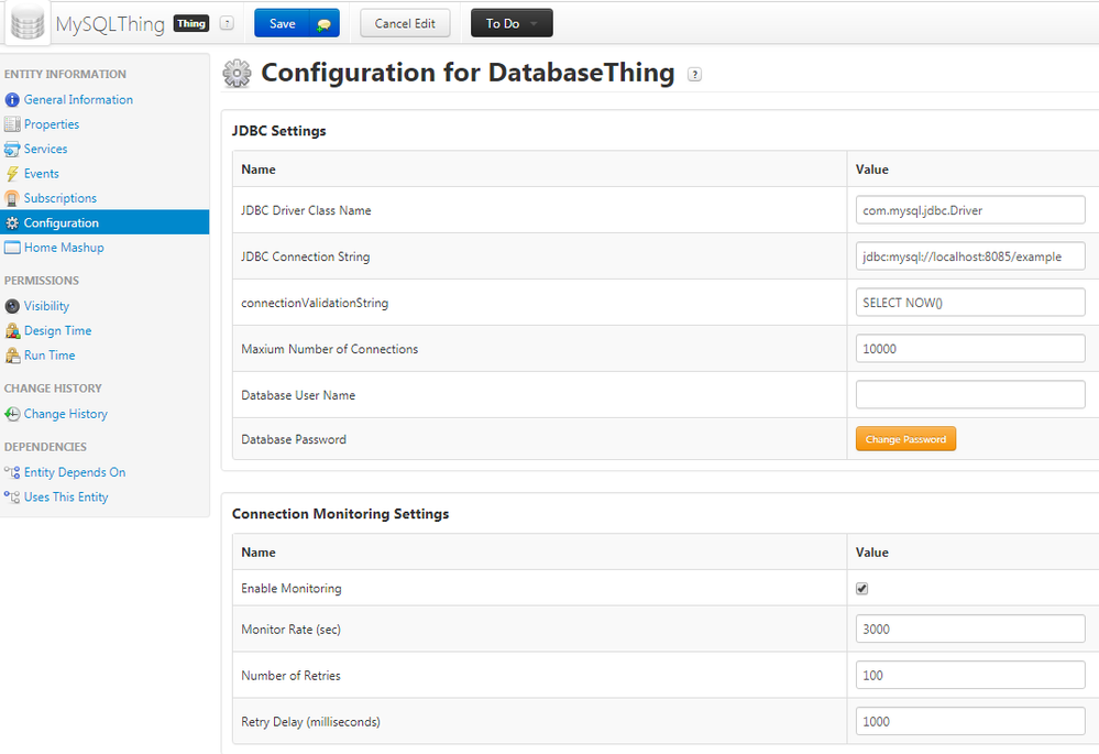

Hello! Perhaps there was already such a question, but still. A service of SQL-query type produces the following error when I try to test it:
There is a connection to the database itself, there is a data in it too. As I understand, the problem is that my service is perceived as empty. But I don't understand what could be wrong.

How did you check your database connection? What is your configuration on the jdbc thing?

I took the configuration from MySQL Extension and changed the name of the database and address:
In properties I set the isConnected property to true:
The service itself looks like this:
"ex" is the name of the table in the database "example"

Please refer to this page to change the connection string and the validation string accordingly:
http://support.ptc.com/help/thingworx_hc/thingworx_8_hc/en/#page/ThingWorx%2FHelp%2FExtensibility%2FJDBCExtension%2FJDBCConfigurationExamples.html%23
When you database is properly connected -- you should not be changing isConnected to true, it will set automatically -- in your service, click on tables/columns and you should be able to see your data. If it's not properly connected you won't see anything.

The problem is that these lines differ in details depending on the specific database. Therefore, I don't quite understand how, for example, set the configuration for My SQL or MS Access / Ms Excel databases.
In addition, the configuration shown in the screenshot above is taken from the downloaded extension directly for MySQL, where, in theory, it's already set correctly for a specific database. Only the address and name should differ.
I know that there are examples of the connection strings on the link in the table, but, to be honest, it didn’t help much and didn’t work for the same Access or Excel. Maybe the problem is in the drivers.

The problem with this extension is that it's pretty old and contains very old drivers (as noted in the marketplace, it's no longer supported).: https://marketplace.ptc.com/apps/195356/jdbc-connector-extension#!overview
What I suggest trying is what I described in my response in this thread https://community.ptc.com/t5/ThingWorx-Developers/Using-a-third-party-Jar-file-for-Database-connection/m-p/514861?collapse_discussion=true&page=2&q=jdbc%20extension&search_type=thread
