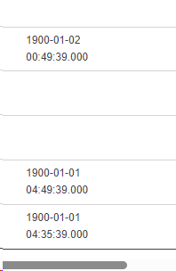

HI All,
I would like to understand.
Why if I have a column of the Time type in the database where I only save the time.
Results from DB looks like that Im using MY SQL SERVER
And I invoke it on the TWX side
Does the time move exactly 50 minutes and 39 seconds forward?
What's going on inside TWX with date data types?
I checked the location of the server and browser - we are in the same time zone.
How can I display exactly the same value like I have on DB?

Hi @Surya_Tiwari
I found the source of my problems.
I had a column of the Time type and the input for entering data into this table was DateTime, hence problems with writing and reading
thank you for help.
