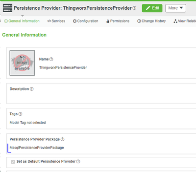

1. First of all please check what kind of persistence provider you have. Each DB has own TWX version.
you can find it here:
You need to select 'show system objects'
I have MYSSQL persistence provider. You can find postgree persistence provider.
I mentioned about it because if you have MYSQL persistence provider this kind of DB will be easier to connect with TWX.

Thank you so much for all the information. I have checked it and it is already connected with MS SQL and all the fields are already filled which you have showed me in screenshot. My question is i am not using the MS SQL to store the data into the Database then why there is still a database connected and what we have there? Actually i am working in a different location and our servers are deployed into another city but i am really curious that why do we have then MS SQL as we are not using it or it comes with thingworx? can you please let me know or whats a purpose of it. I have already raised a question about it in our team.
@JK_10565232 I think i have got the answer of my question. The persistance provider is the one where the whole platform data and information is stored like all entities including user information, things etc
but on the other hand side if we want to store the data like which we store from user that we can directly also save in database MS SQL directly not in datatables. please correct me if i am wrong.
