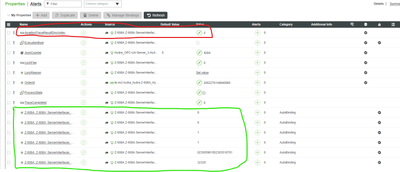

I have a thing where I have binded a remote property from the Kepserver by creating a new property.
Also, I have the same property binded to a property we have created on template level to trigger subscriptions with that.
Now I'm facing that I have a delay in updating the values of the property which is binded to the other property. The property which was new created on the thing does not have this delay.
So, I have 2 times the same property from Kepserver binded to a thing, but the values are not updated at the same time.
The properties in the screenshot in category "AutoBinding" are in sync with the Kepserver, the upper properties are having the delay.
I have already tried with different Cache Options and different settings on the push type, but unfortunately without any success.
Also we have tried for the property from template level as persistent and not persistent but did not make any difference.
Has anyone an idea how that could be fixed or by what this could be caused?

I have noticed that if you try to use a remote binding multiple times, Thingworx can experience issues with that, You could try doing 1 remote binding and then bind the other property using a local binding from that bound property and see if it behaves more consistent.

How are you determining the fact that you have a delay?
Could it be due to scan time or the way VTQ is recorded?
I have seen it in 2 different ways:
1. Connected to KepserverEX with an OPC-UA Client and compared live the value from the property in Kepserver with the bound one in Thingworx
2. We are creating JSON Files out of the Data based on a trigger coming from the machine where we have both properties in, the remote property and the bound property and there we also see that the one which is bound to the property from the template has the value which was before the one of the remote property

Is the property value consistently a value behind?
Could you perhaps install WireShark or something similar to see what is transmitted when an update happens on the Kepserver side to make sure it is transmitted. If that transmits on update then at least that eliminates one part of the mystery.
What basetype are these properties btw?
Should be always a value behind, normally it toggles between 3 different values depending of the process state of the part which is processed.
I'll try to have a look with wireshark to see if there are maybe some more insights on that.
We have different base types where this occurs.
The property which is bound remote and then local is an Integer, but we have also a Boolean property which is only bound one time to the property from the template and not bound remote where this happens.

we have assembly machines connected and need to store the process data for traceability reasons. Therefor we have some subscriptions and services which are running some processes which among other things are creating JSON files for an other system. Some of the properties we need both in the JSON file and for subscriptions to be triggered.
But please do not be fixed on that we are having sometimes properties 2 times bound. This happens also when we the property only 1 time bound.
In fact, this happens only at the properties which I have bound to the properties from the template on not on the properties where I have created new properties on the thing.
E.g. the green ones are updating in sync with the Kepserver, the red one had e.g. yesterday a delay of > 5sec to the value of the Kepserver.
So the complete Handshake we have with the machine was not working anymore. And this is a property we have only 1 time bound.
KepserverEx I'm running V6.12.325.0
Thingworx Software Version 9.3.1-b156
Simon
Could it maybe be due to the Tag Count? There we have currently about 8600 tags from 1 Kepserver.
Or maybe the Publish floor from KepserverEX to Thingworx? This is currently set to 250ms.
Store&Forward is also currently not enabled.

Today I even faced that I have a remote bound property (Boolean) which was working and updating as expected but then I've put a DataChange Subscription on that and it stopped updating the values. Even after disabling it did not further update the value until I deleted it and bound new.

we have found another possibility that it might be due to a subscription which is on "AnyDataChange" and doing with the same logging at info level.
We are currently changing our concept and trying to disable this subscription.
But what I also faced is that I switched off the machine physically and after switching on again everything worked.

We definitely recommend changing or deleting the subscription configured for "AnyDataChange."  With the push rate coming from Kepware, this can flood the subsystem with events resulting in queuing, which in turn can cause events to be processed out of order.

Another issue we could already fix was that at some machine the NTP server at the PLC was overwritten by an update and then under certain circumstances it also started to not further update the values. After setting up the NTP server again it was also updating again.
But still some problems at other machines where we have the NTP server correct, but as it seems mostly at things which have lots of properties (>400) and there I hope that disabling this "AnyDataChange" subscripton will help.
