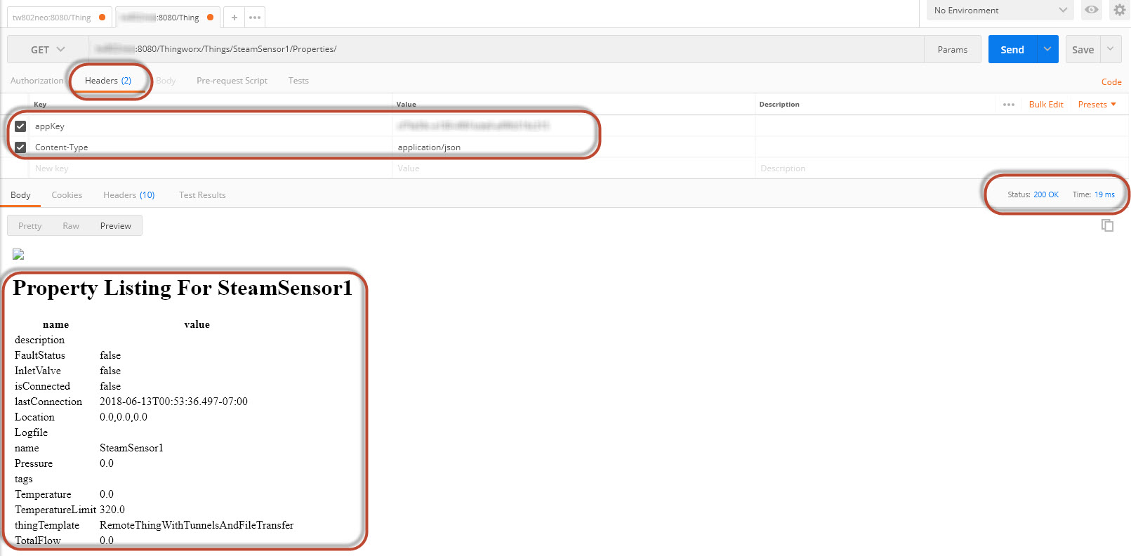

Hi @gkumar-21 its definitely possible to to do GET/PUT/POST, etc. using the ThingWorx REST API, both with Postman or cURL lib. I'm not sure how you are trying may be the syntax is incorrect? As you can see below I'm performing a GET request using Postman with desired results
If you have not already explored the documentation on this, you can refer to this link ThingWorx REST API, it'll help you correctly structure your calls to ThingWorx

I have used REST API to send and receive information from thing using CURL and Postman and it works fine. This is about a normal thing.
I have created a thing (let us called  SensorThing) While creating SensorThing, I had used a pre-defined Template Called RemoteThing. To my understanding this  template is used when we need a "ALWAYS ON" Connection.
Next step what I did was send data (PUT) to thing this using postman or CURL, but the data is not reflected in the properties of thing.  I looked at the guides and able to understand that they are using a JAVA-SDK based program for sending data to this thing. I also understood that C-SDK or JAVA SDK is used for creating an "ALWAYS ON" connection. with thing.
