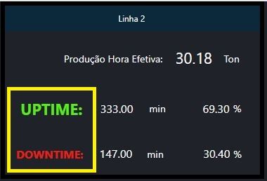

I am working with two monitors. One monitor is 1920 x 1080 and the other is 1366 x 768.
I have created a mashup type responsive and that mashup I am using widget called value display (to show some informations).
I was able to realized that the value display is responsive widget but the font that is into the value is not.
Followed below the images that can help to undertand the problem:
1920 x 1080                                                                   1366 x 768
My question is: There is any way to do the value display's font be responsive too?

From your images, are Uptime and Downtime just labels?  Which version of ThingWorx are you running?  The latest releases have some beta widgets that may scale better.

Hi @einsfele.
From your images, please advise if Uptime and Downtime are just labels?  Which version of ThingWorx are you running?

einsfele
(To:slangley)
Uptime e Downtime are value displays.
I am using ThingWorx Foundation 8.4
