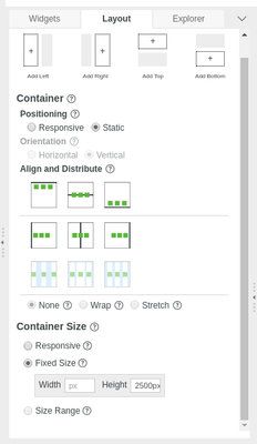

1. In the Mashup builder select Layout tab, change Positioning to Static and set Fixed size to your desired Height. Leaving the Width field blank will allow Thingworx to set the Width automatically and stay responsive.

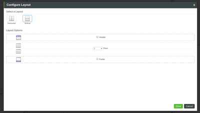

2. Now you need to plan in advance a little bit. Select a Layout widget and drag it to the blank page. A window similar to the one shown below will appear. Switch to Vertical orientation, choose your desired number of rows and click Done.

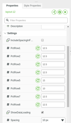

3. Your panel is now divided into equally spaced rows. Now you can change the proportions in the Layout widget properties.

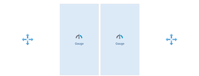

4. If you want to leave spacing around the sides of a widget, you can simply add another Layout inside of the existing one and create multiple columns. You can add more rows this way as well.

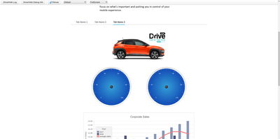

Here is a screenshot of an example mashup with the scrollbar clearly visible.
