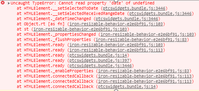

I am trying to initialize a DateRange datetimepicker with default start and end date and get following message in the console. Furthermore, the "done"-button triggers no event
See attached screenshot.
I am using ThingWorx 9.1.0
Thanks in advance

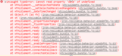

(To:PaiChung)
I have generated start and end datetimes and binded to "StartDate  and "EndDate" widget properties but get this error message
PaiChung
22-Sapphire I
(To:AK_9796023)
can you map them to a ValueDisplay as well, or just check in the dev tools what the values are that you are bringing back. Since it seems to call out 'null' perhaps what you are generating is not working or perhaps not the format it should be.

Hi @AK_9796023.
Where are you setting the datetime value?  Since you're getting an error "Cannot read property 'date' of undefined" it sounds like you're not feeding in a datetime base type. If that appears to be ok, you need to check that the service is able to run successfully.
If you can provide your mashup, service, etc., we can review in more detail.

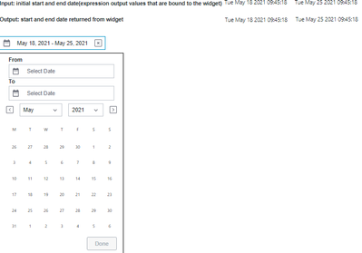

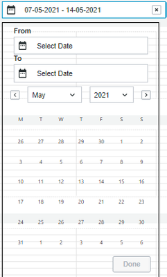

Hi @slangley,
in the example mashup is above the problem with the default range initialization where i set the datetimepicker with the start and end date expression values.
Below you will find the problem with the datetimepicker changed event. When I click "Done" a service should be called, here in the example i have an expression, which unfortunately does not work. It triggers only when click the "clear"-icon
