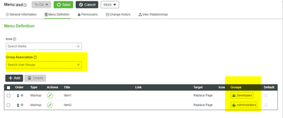

If your users are in userGroups you can show menu items based on the groups by assigning groups to the menu entires:
Check: https://support.ptc.com/help/thingworx/platform/r9.5/en/#page/ThingWorx/Help/Composer/Visualization/Menus.html
If you do not have the users in UserGroups you would need to create a service which returns a menu structure where you added the entries based on the users category - basically like descibed in https://www.ptc.com/en/support/article/CS249303
