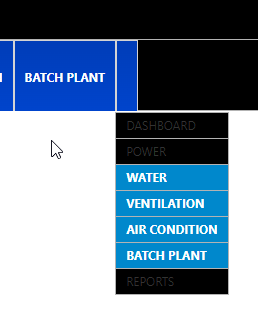

Currently what I do have is this:
The title has disappeared for the item of the main menu whose type is menu. (see the missing title below).

The above should give you something like this (see image attached)
